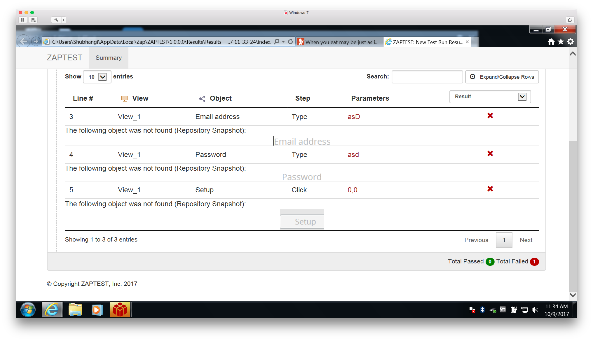

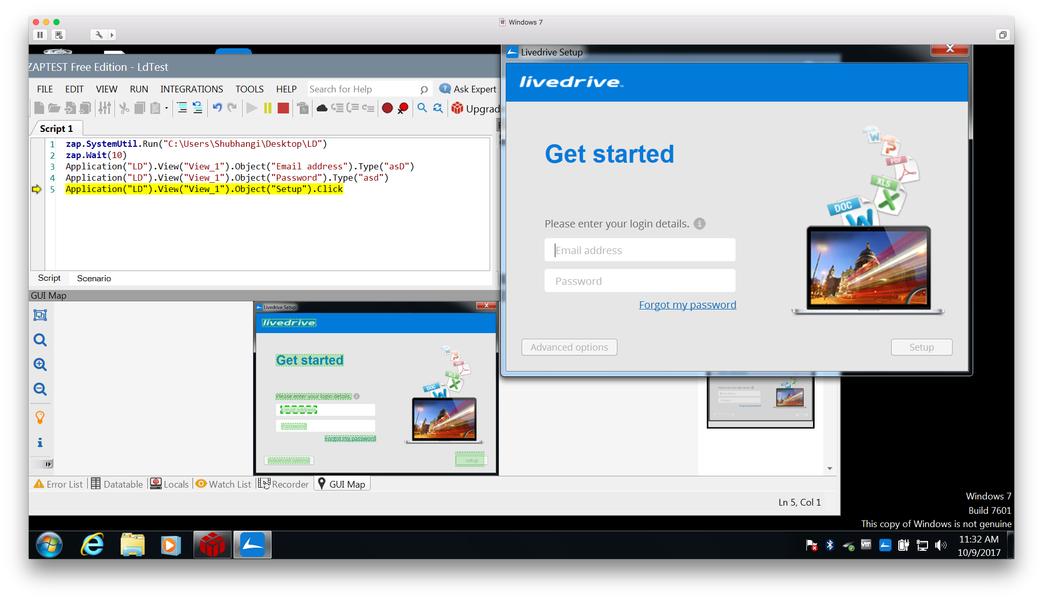

      Now, When I re-run the script, Zaptest can not find elements on the window and fails.
      I looks like the repository element are tied with the instance of the Window and do not work with different instance.
      I have attached the screenshots of my script and UI map.
      I am not sure, if I am missing something here. Has anyone encountered this issue before? How do I get around this problem?

                Can you try following:
                Create couple of different scripts with the same application but each time running new instance of the same application.
                Then check in repository explorer property of Application object. See screenshot.
                Check if “regexpwndclass” and “regexpwndtitle” are remains the same or changing in different scripts. This may be the root cause of the issue.
                #31332
                Shubhangi Shingade
                  Hi Kirillb,
                  Title remains same, however the class shows following for different instances.
                  HwndWrapper[Livedrive.exe;;7d8542e2-5178-4d9f-9cdd-2cd2ca688c48]
                  HwndWrapper[Livedrive.exe;;dd6f26c5-c6fd-44a3-9d9c-6f05530cf549]
                  IS there a way to use regex while defining the class or title ?
                  #31333
                    OK that’s exactly what I suspected of.
                    Please remove everything except “HwndWrapper[Livedrive.exe” from regexpwndclass. That should help.
                    #31334
                    Shubhangi Shingade
                      Thank you, worked. Atlast can find the application window.

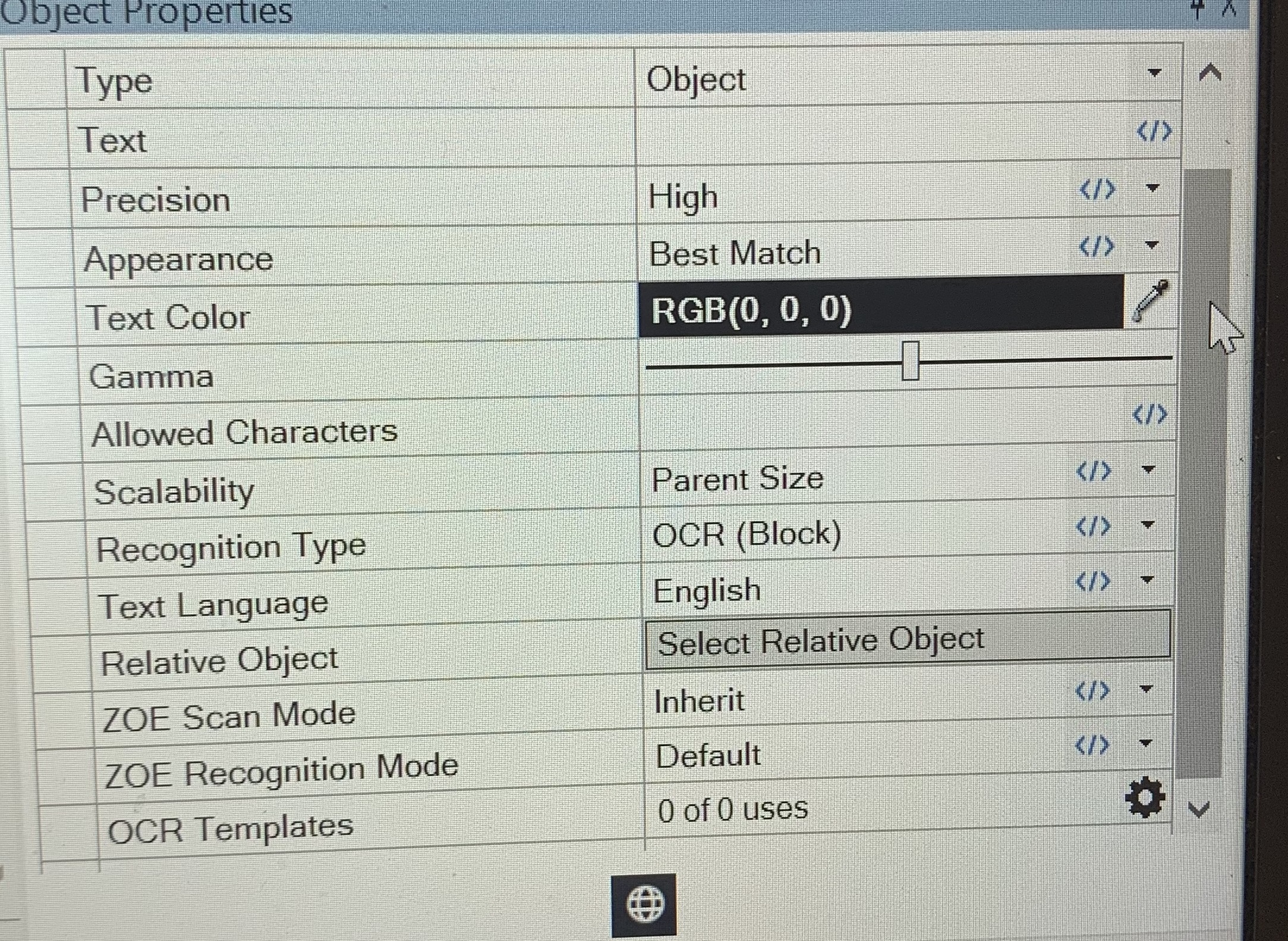

                      When I launch the app exe, application setup window is launched with username credential textboxes. The user name text box is focused by default. Hence the OCR scanner sometimes, recognises Text as ‘lEmail Address’ (String with cursor).
                      Sometimes this makes the script to fail. Any workaround for these situations.
                      Regards,
                      Shubhangi
                      #31335
                        Try to use “OCR Partial” recognition for this object. That should resolve the problem.
