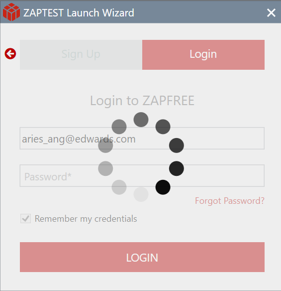

          Thank you, for helping us to improve ZAPTEST! What kind of message/window could you see for a second (could you provide a screenshot)?
          Could you also check the “Event Viewer” (system application) application for any crashes?
          #32539
          Aries Ang
            Screenshot a attached.
            After I attempt to launch the app, this screen will popup briefly for 1-2s, then it will close off and nothing happens after that.

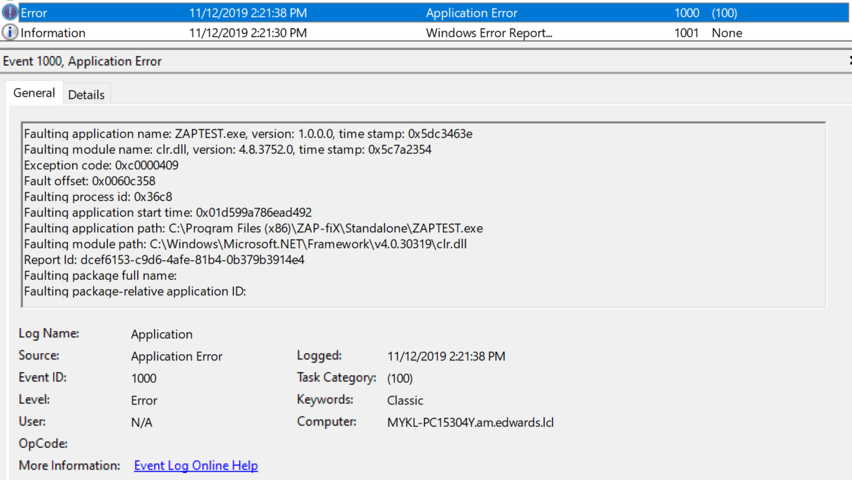

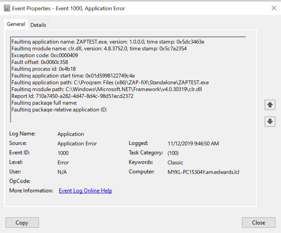

              Could you also check system Events? You should open “Event Viewer” system application and check for possible crashes around ZAPTEST.exe.
              #32541
              Aries Ang
                Event log as attached
                #32542
                Aries Ang
                  attached is the event log

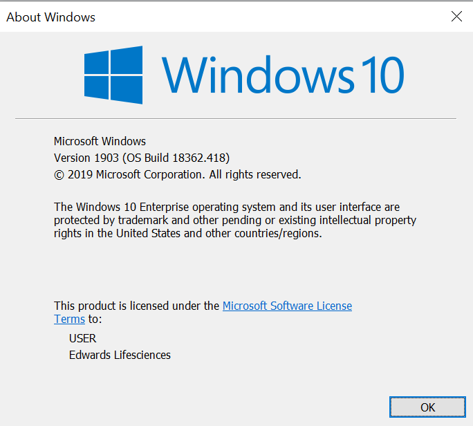

                    Thank you, for the provided information. We forwarded these errors to our RnD department. Meanwhile, could you provide information about operation system (version, build)? Do you use a proxy?
                    #32544
                    Aries Ang
                      I am using Windows 10. Details as attached.
