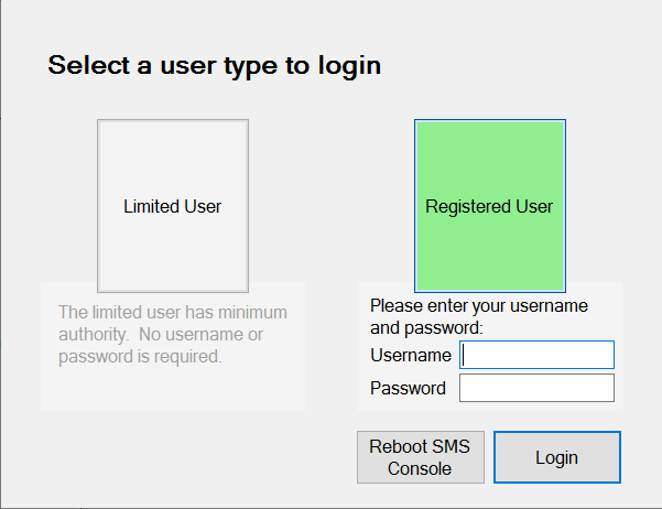

ParticipantHi,
I am trying to write script to send type command into application under test but cannot seem to work.
i want to type “Admin” into username field. When I execute script, that step result shows passed in execution result but I don’t see “Admin” typed.
Please see attached screenshot, thanks.

Can you check please if when the AUT is being executed by ZAPTEST this Username input box is disabled?

Can you please attach your test (attach the *.zap file) and if the AUT (Application Under Test) is public send me its URL and if not please attach also a screenshot of the page with the problematic Username text-box.
ZAPTEST TeamJune 15, 2018 at 9:28 pm #31855Gurpreet Singh
ParticipantThanks Sasha for your help.
I have attached script file and screenshot.
Attachments:June 15, 2018 at 10:40 pm #31856Sasha ZAP
ModeratorHello gsingh2014,
I’ve ran your test in my end and it appears your Username object cannot be recognized during runtime:
Can you please rescan this page and try again.If the above will not help do the following:
Remove the “regexpwndclass” Application’s object property value and run the test again.Thanks,
