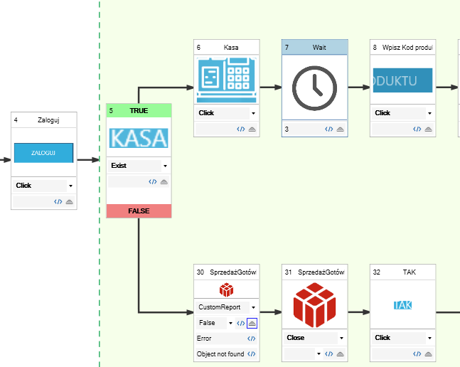

Hello Michael
Yes, you are able to preset Exit method timeout.
You can do it for entire ZAPTEST – go to Tools – Options – Runtime. And there you can find “Global Timeout” – the value in milliseconds, by default it is =45 seconds. You can set a value that is more acceptable to you.
Another point is to set up Exist timeout for a specific step/code line. For example, in a step view, you can see parameter line below the Exist method – place cursor there and you will see the tooltip – it says that you can specify a timeout for Exist there. This way you can set it up specifically for the required object.
