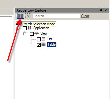

      Hello jena.lnarayan,
      In order to select or unselect objects you need to click the upper left button in the Object repository named “Switch selection mode” (See attached screenshot “switch to mode.jp”).

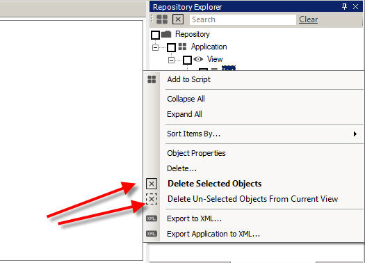

      In order to delete selected objects or to delete unselected objects you need to do a right-mouse-click on any object and select the required option (See attached screenshot “delete options.jpg”).
          In order to select or unselect objects you need to click the upper left button in the Object repository named “Switch selection mode” (See attached screenshot “switch to mode.jpg”).
