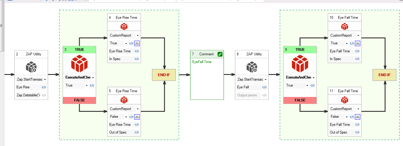

        Alan Carr
          My API testing using GUI mode has a series of tests and assertions I wanted to know when each test occurred such that if a test fails I can further analyze to see if anything else may have occurred at that time to make the test fail.
          I added at the start of each test zap utility “Start Transaction” that added the text to the report however No timestamp appeared at that step. I guess somehow I need to add variable for time however I’m not sure how to do this.
          What resolution is available for the timestamps “Start Transaction”

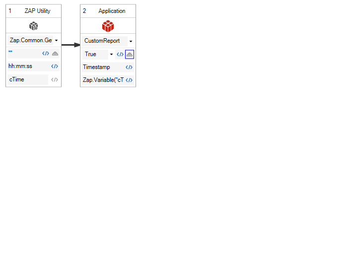

          Alan Carr
            Screenshot

                #32387
                  In the Step view you need two steps
                  – assign current time value to a variable
                  – include the variable in the CustomReport step
                  In the Script view the steps are:
                  cTime = Zap.Common.GetFormattedDateValue(“”, “hh:mm:ss”)
                  Application(“Application”).CustomReport True, “Timestamp”, cTime
