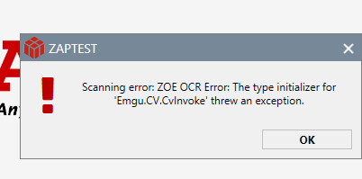

      Hello,
      How can I solve this error ?

        Hello e.krits1993,
        Are you using a machine which is compatible with ZAPTEST(?) – These are the System Requirements for ZAPTEST:
        • OS: Windows 7 or higher
        • Processor: 1 gigahertz (GHz) or faster
        • RAM: 1 GB (32-bit) or 2 GB (64-bit)
        • Hard disk space: 1.5 GB
        • Libraries:
        o .Net Framework 4.7.1
        If the above is correct for you try to reinstall ZAPTEST (It is best to do it if you are the Administrator of the machine):
        Uninstall ZAPTEST completely and then install it again, after doing so restart your machine, if the issue repeats itself there is a possibility your ZAPTEST installation file got corrupted in such case you’ll need to download again ZAPTEST.
        Please let us know if the above solved your issue.

            Hello E.Krits1993!
            It seems like ZAPTEST cannot load one or few libraries from x86 folder. Could you try to reinstall ZAPTEST?
            1. Uninstall current version
            2. Reboot your PC
            3. Install again
            If you still have an issue or you already tried the first step. Could you copy all files from “C:Program Files (x86)ZAP-fiXStandalonex86” to “C:Program Files (x86)ZAP-fiXStandalone” folder? Please CLOSE ZAPTEST before doing this operation.
            Does it help?
            If not – could you try execute attached script and show errors? This script opens http://www.zaptest.com in a chrome browser, detects 2 objects (OCR and Image based) and then closes browser.

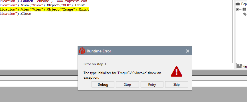

              3. Run the script and gave the following.
              In option number 2, was I suppose to delete x86 folder after copy & paste action?
              In option number 3, this is the error I could find and Chrome browser did not close as it was supposed to. .

              #31651
                Hello E.Krits1993! Thank you for your time and help to make ZAPTEST better!
                In option number two you suppose to copy the folder without removing content.
                Could you provide full information about your OS? Version Build, version of installed .NET library and C++ Redistributable packages (you can find this information in “Control PanelProgramsPrograms and Features”). You could attach a screenshot(s) with erasing other apps info.
                Another question is – could you replicate this problem/issue on other machine?
                It seems there are some kind of problem with C++ Redistributable package. As an option could you also try to install the latest VC 2015 Redist package: Visual C++ Redistributable for Visual Studio 2015
