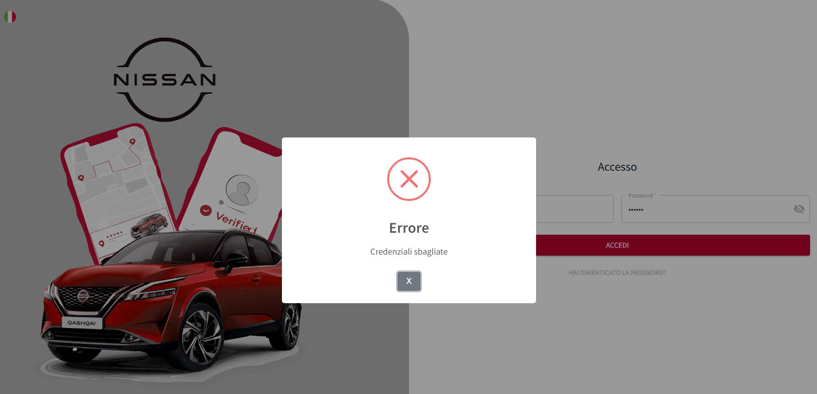

                    P.S. Your UID does not work and I could not run the test and debug it(See attached “nisan credentials error.jpg” screenshot).

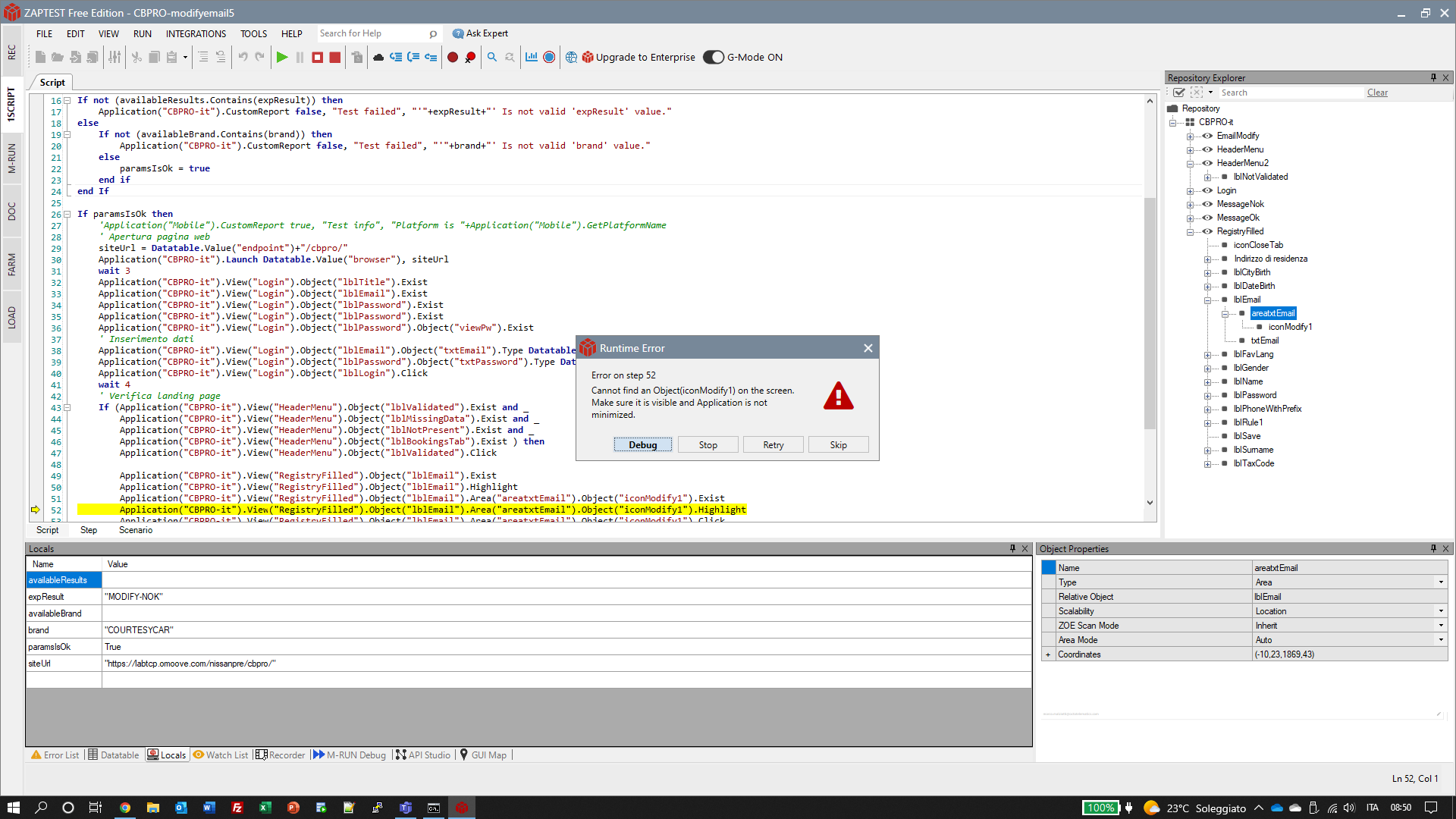

                          With your script I obtain this runtime error (resolution is the same that views stored in the repository).
                          Password is Octo2022
                          Still wondering what the scalability field is for.

                            I’ve attached updated test with a completely new line #56 which was added with new added objects (This new line does work in my machine):
                            I believe although you’ve managed to highlight your Email object this is occurs mainly due to its OCR recognition mechanism;If you are assigning Area and Image based objects it is best to add them from the machine with the same environmentresolution you are using to execute the test from.
                            The Scalability property uses the relative locationsize of an object (To its assigned Relative Object), this is especially helpful for the Area and Image based objects (Which are not an OCR based objects), but there are cases which it may not work properly (I believe like in your case) – In such different environments it is best to do the following:
                            – Adjust the environment which the script does not run in it properly to the same environment’s settings where the test does work;
                            – OrAnd add new objects (Especially Area and Image based objects) from the environment where the test has trouble to run successfully, and create a condition when to use such object.
