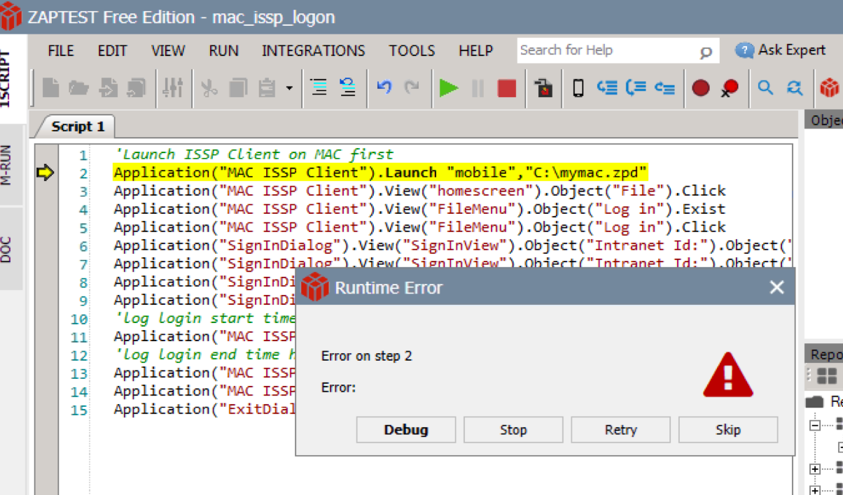

ParticipantI am still trying the use the 1-script tab for the playback. I am coming across with this issue: When I open the zpd file initially with Application(“MAC ISSP Client”).Launch “mac”,”C:UsersAdministratorDocumentsmymac.zpd”, it is opening too big a screen and not the whole screen will show in the ZapViewer. I know reducing the screen resolution will make it work but I have tried changing the resolution to Custom in the zpd file but it takes no effect. Any one came across with this problem? Attaching my zpd file
June 27, 2017 at 12:58 am #31146Kirill Bulatnikov

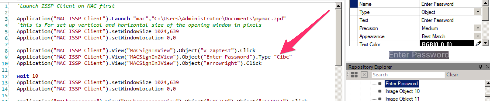

My next challenge is now on the Type method at the password prompt…. I am using the Type method but realized that it is not typing in the letter ‘C’ correctly (encrypted or not)! Is that a known issue?June 27, 2017 at 11:05 pm #31148Kirill Bulatnikov
ParticipantIs it a problem of entire “type” method on your side or some exact textbox? What it insert instead of “C”?
June 27, 2017 at 11:07 pm #31149Andrew Chan
Participant“c” was inserted instead…
seems like all the ‘SHIFT’ characters are not typeable (ie. “@”, “#”, or any of the capital letters).
June 28, 2017 at 12:28 am #31150Kirill Bulatnikov
ParticipantCan you please provide a bit more details? What is the case when you are unable to input uppercase “C”? Is it in M-Run or in viewer? Is it in any text fields or some certain form/field?
June 28, 2017 at 1:35 am #31151Andrew Chan
Participantthe script itself is really straight forward (see attachment of where it calls Type). I have tried the same on other text field and same result. Maybe this only happens on MAC as I have used Type method on Windows Application before with no issues. I am using 1-Script Viewer and playback on a standalone application on MAC. Hope this has enough details. Thanks!
Attachments:June 30, 2017 at 9:50 pm #31152Kirill Bulatnikov
ParticipantHello
We re-test this case and found this is a bug which is affected by VNC protocol interaction with MacOS. Our R&D working on it and this bug will be fixed in next release.Thanks,
