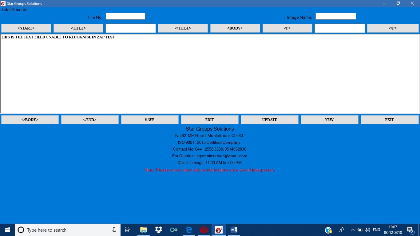

      Hi dvikram004. Thanks for using ZAPTEST.
      As I understand the only issue is “UPDATE” object, right?
      In fact I was able to detect this object, see screenshot attached.
      You may try also to restart ZAPTEST or reboot your PC – sometimes when the windows is slowing down a bit it may affect to OCR performance.
      Another thing is try to create manual object with text UPDATE and try to check it with Exist method on the real application. Then see in the results if the correct one found. You can use Highlight method as well to see your object highlighted during script execution.

      vikram d
        Hi kirillb
        All the button in the windows applications are identified correctly. I am mentioning about the big text field where i have to type. The zap test is not getting detecting that particular fields. If require i will share the exe application.But i can send it to your email.

        vikram d
          Hi kirillb
          All the button in the windows applications are identified correctly. I am mentioning about the big text field where i have to type. The zap test is not getting detecting that particular fields. If require i will share the exe application.But i can send it to your email. I have type the content in one text field, that big field only its not getting recognized, which i have attached in the previous comments.

            Hey dvikram004
            Thanks for explanation
            So I re-checked and was able to recognize the text you are talking about either
            If you are willing to put many text there and it will not fit the single line then select OCR Multiline for this object.
            While scan your screenshot I had issues with auto-recognition of upper objects as of “Total Records:” and “File No:”. However fine tuning of the object properties make me able to have it recognized perfectly – you may see screen shot above. And below you can find the properties for these objects – it was important to adjust text color, color tolerance and gamma due to low contrast between text and blue background. Here is the adjusted properties. You can try it by your own with some different objects.
            #32160
            vikram d
              Hi
              I have gone through the comments you given. Even though my issue is not solved. I am mentioning about the big text field, not the label or text boxes in the application. I have type the words in big text field that “”text field is not getting recognized by zap test””. I have tried many times even though its not getting recognize. The same words mention above i have written in the text field. Other filed are getting recognized perfectly. Only i mentioning about the text field.
              #32161
                Yes, I have seen the string “the text field unable to recognize” and as you may see on the screenshot it’s been caught by OCR engine. I did a scan from the screenshot opened in graphical editor or directly from browser – both works well. Have you tried that way? Please try that way for the experiment.

                        Hello Vikram
                        Please try following. Create manually object within the view and set the Text property as a text you want to recognize in the particular field. See screenshot:
                        Then insert line to the script with Exist method applied to this manual object. If it works then you can parametrize Text property from script (by using SetProperty method) or from datatable.
