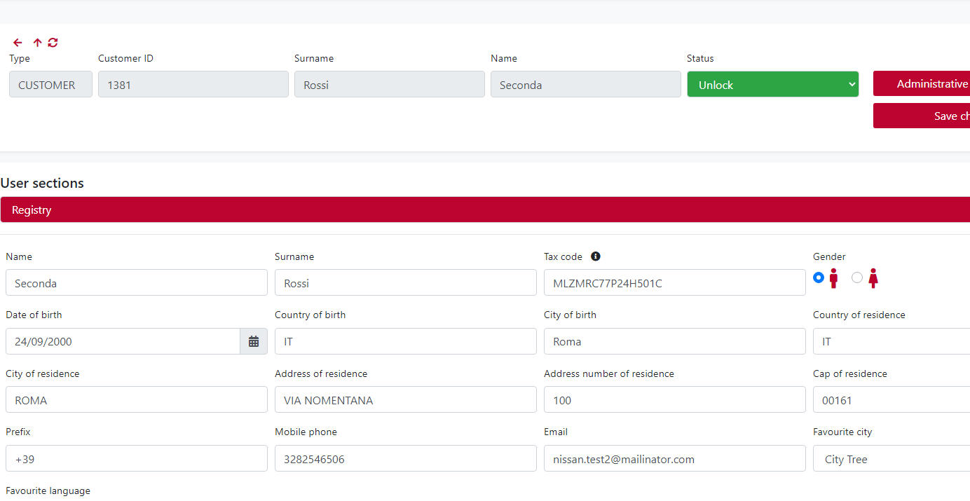

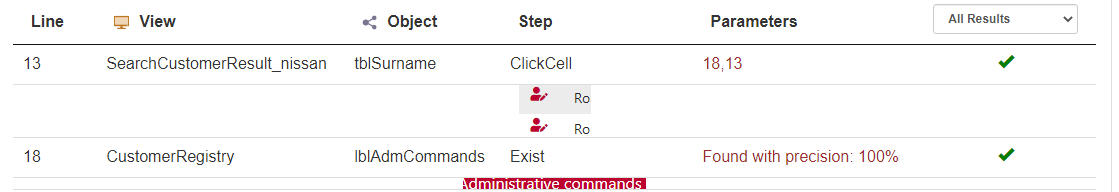

                I’ve fixed a bot the “item-selection_ZAPFIX.zap” and now it does click the Surname icon (See also the 2 attached screenshots).
                Hope this will help you.
