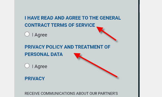

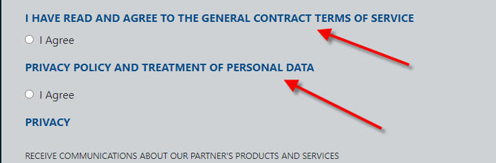

            Basically the web page as it appears in the Desktop web site is a bit different then as it appears in the Mobile web site:
            In the Desktop site the parent objects above the “I Agree” radio-buttons appear in a single line (See attached “desktop web page.jpg” screenshot), while the same objects in the Mobile site appear each in 2 lines (See attached “mobile web page.jpg” screenshot), this means the parent object in the Desktop site will not be recognized in the Mobile site and vice-versa (And because of this the “I Agree” radio-buttons will not be found) – Therefore there is no other option but to use the condition you’ve commented in your test and set the 2 objects for each of the web pages’ origin.
