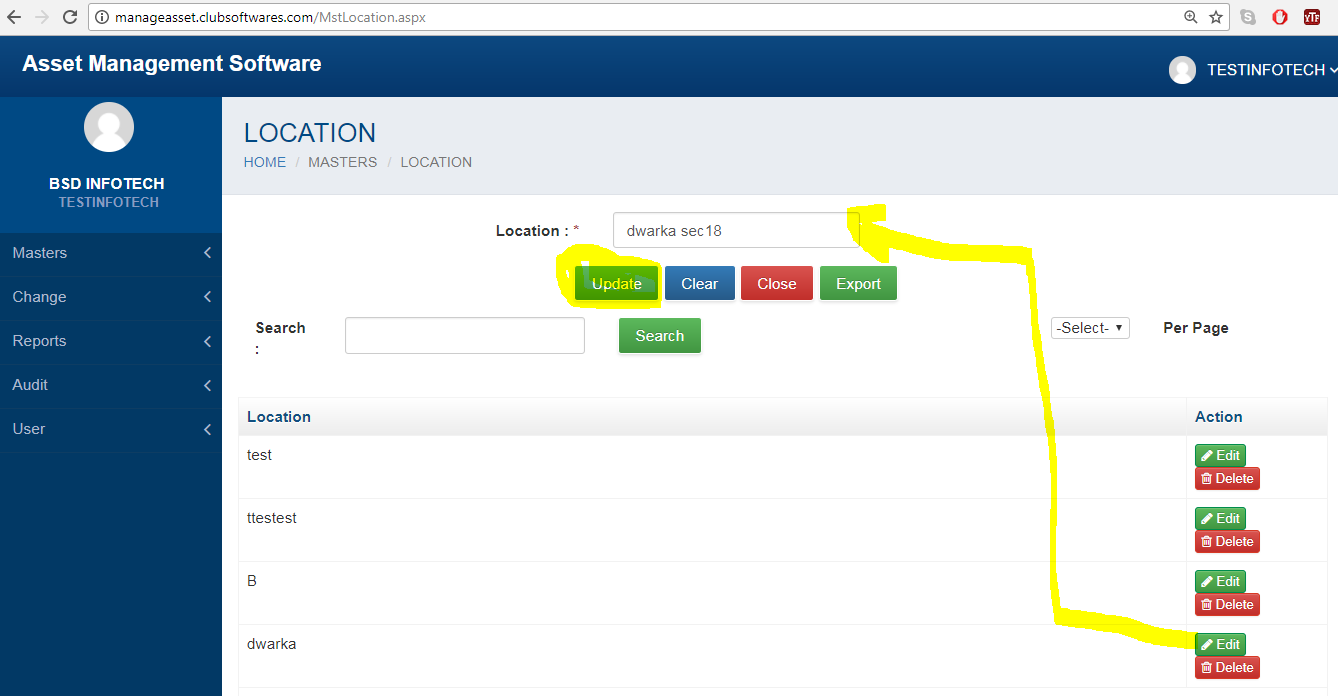

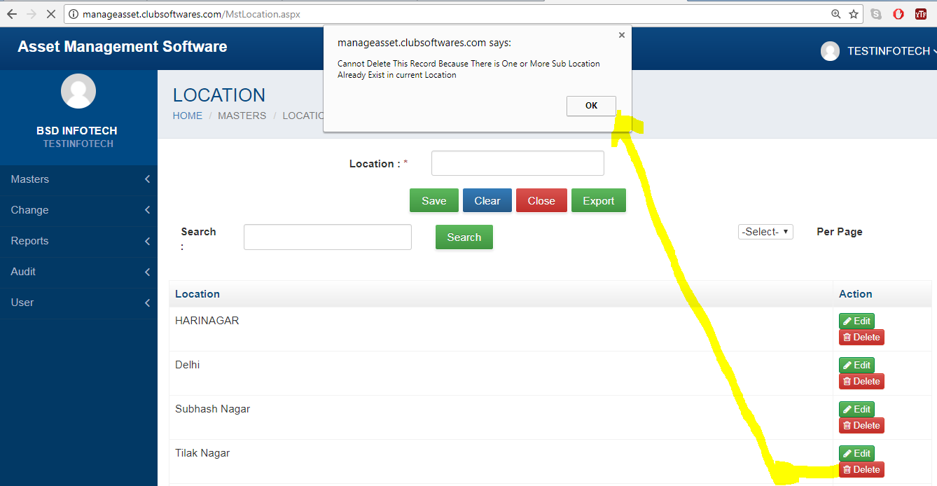

ZAPTEST TeamJuly 21, 2017 at 3:29 pm #31198NIKITA SINGH
Participantshared you software module screens for edit &delete the record. I hope these screens help what i want
screen 4- screen of module
screen no.5 – when click on delete button then message coming you will see in screen , my question is that how to write the particular script for this procedure
screen no. 6- when edit the record the -how to write the particular script for this procedure

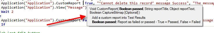

ParticipantCan you explain this script line – CustomReport False, “Record Already Exist Error”, “The message ‘Record Already Exist’ did not appear.”, True
Note: what is the meaning of CustomReport
July 24, 2017 at 10:02 am #31203Sasha ZAP
ModeratorHello nikita,
Are you using the ZAPTEST Free Edition or the Enterprise Edition?
If the Free Edition then please check the attached file.Thanks,
ZAPTEST TeamJuly 24, 2017 at 10:27 am #31204Sasha ZAP
The “CustomReport” method enables you to send more customized report to the final test’s run results file;
Also it advantages upon other reports’ methods is in the fact that you do not have to use specific object (Except of the Application Object type), which may not be found by the test during runtime to generate the report.
Please check the “CustomReport” method’s tooltip to understand its attributes (See attached file).Thanks,
