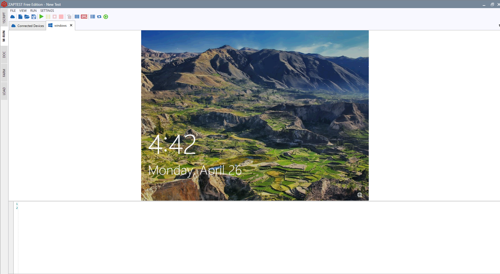

      Otherwhise if I fill in the “Create new connection” view with the following data:
      – Connection Name: Windows
      – ScriptHost: :5901
      – username:
      – password:
      and click on Add.
      I see “Enviment manager (host Y)”, then I select for example “chrome” browser, then I enter path for example http://www.uai.it… but now see host Y lock screen (see attachement “connect via zaptest agent – result.png”).
      If now I access via RDP on host Y, I see chrome open on path indicated!
      In the host Y “event viewer” found following events (see attachements event1.txt and event2.txt).
      Can you help me please?
      Regards.
      #32800
        Hello Marco!
        For the VNC connection to work a user account must be logged in to the remote machine (and unlocked).
        As a workaround, you can use RDP connection and define steps to open Chrome on the remote machine (i.e. by double-click its desktop icon).
