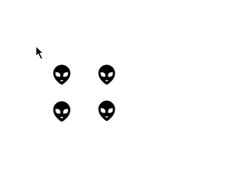

      I’m trying to figure out how to do a click – drag – select action like the one below:
      What methods I can use here?

        Hello Joey,
        Please use SwipeTo method.
        Define two objects for start and end of the swipe operation. Those can be relative objects.
        This is an example of the step:
        Application(“Application”).View(“View”).Object(“File”).Object(“dragStart”).SwipeTo Application(“Application”).View(“View”).Object(“File”).Object(“dragStop”)
        #32698
        Joey Dingo
          Thank you! it works. 🙂
