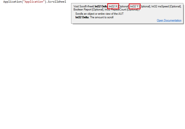

      #32389
        Hello mclifton!
        Please use X and Y arguments to position mouse pointer over your scrollable area.
        The prior MouseMove step is not required.
