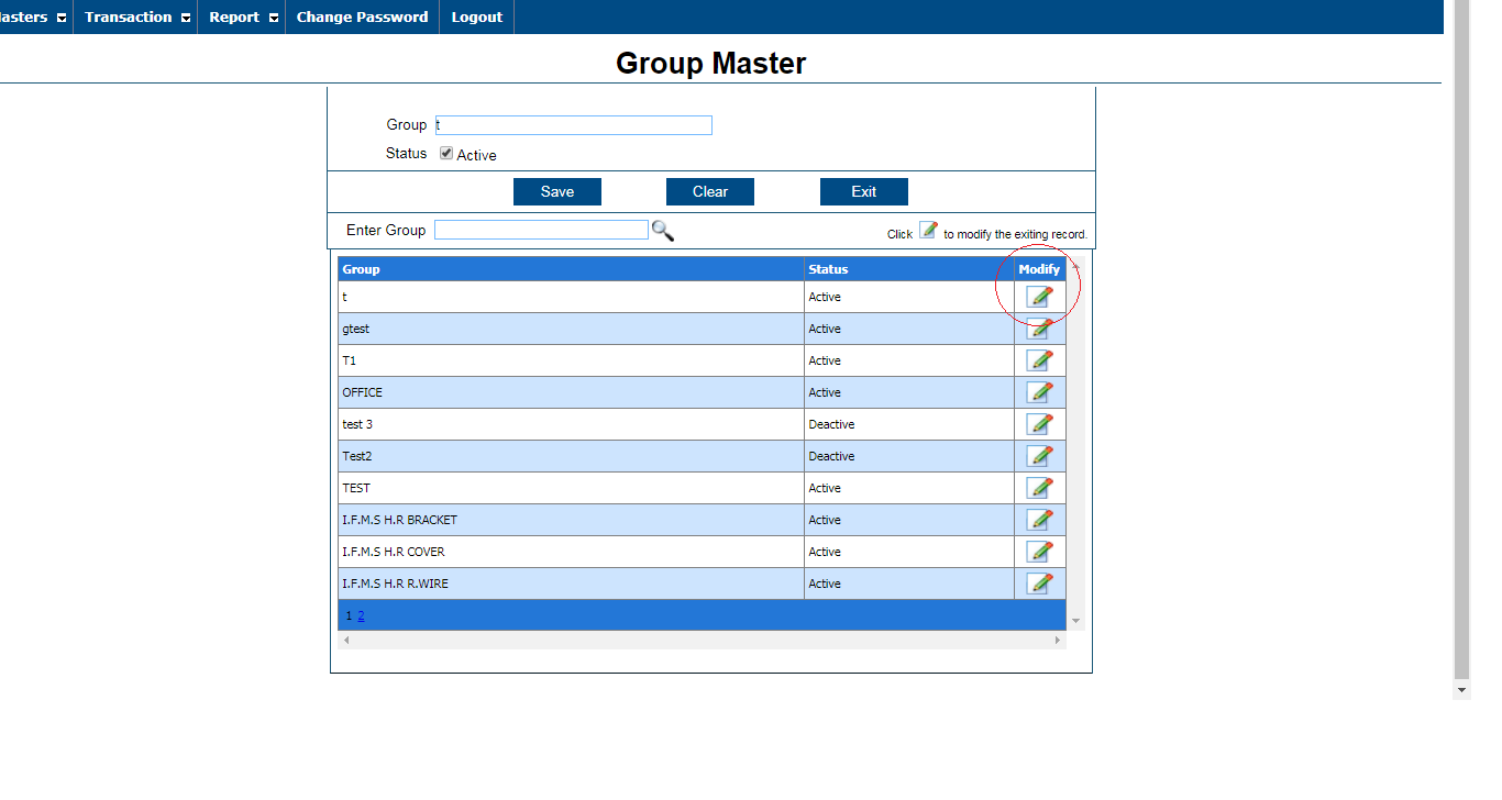

      Hello Nikita
      As I understand your main difficulty is presence of multiple similar icons to click, right?
      If so then I recommend you to play with Appearance property – number in this property means serial number of the exact object (e.g. if you want to click 3rd “modify icon” you need to set Appearance value to 3 – note that the 1st one is not in list but in header so 3rd one will be only 2nd in list).
      In your case you also need to set recognition type of the object to “Image”.
      #31180
      NIKITA SINGH
        I want to be click 1st “modify icon” can I set Appearance value to 1?
        #31182
          As you can see 1st is not in list – it is above, so to click first in list (highlighted with red circle) you need to set Appearance = 2
