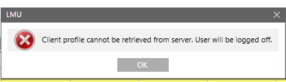

    Saurabh Jain
      Getting error (please refer attached img) while launching desktop application. But after stopping the execution report shows launch app step as Pass. But in reality application not get started.
      Can anyone tell me what is the issue and How to solve this?
      #31257
        Hello, thanks for using ZAPTEST
        The error looks like something wrong with user’s permissions. What application you are trying to start to?

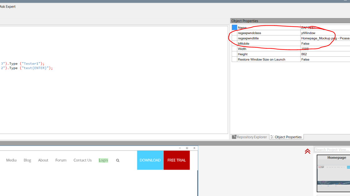

                You can go to the properties of application in Repository Explorer and set static value of regexpwndclass/regexpwndtitle. See attached screenshot.
                Or you can set it dynamically with SetProperty method.
                Application(“”).SetProperty “regexpwndclass”, “HwndWrapper”
