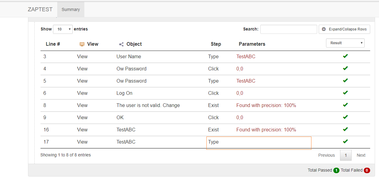

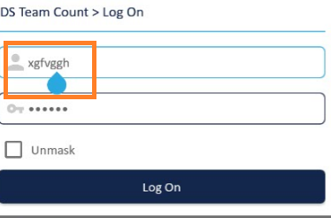

      Hi ZAPTEST Tea,
      I am facing one problem. when I cleared the login field it started middle of the text field not from right side that’s why field is not prospered cleared.
      See Attached file.
      Regards,
      AQU
      #31407
        Hello aqu,
        This happens because you first use the method “Click” which sets the position of the caretcursor in the middle of the object (“TestABC”):
        Instead of using “Click” please use Exist”.
        Let me know if this helps.

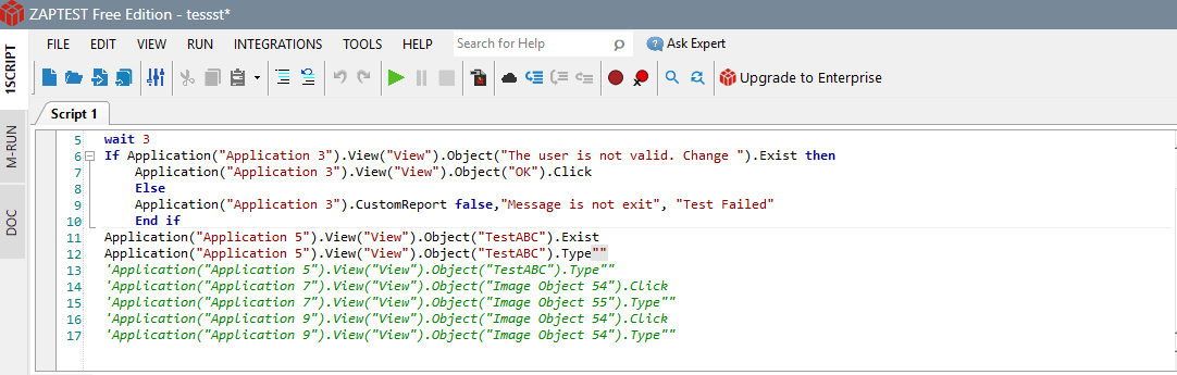

        #31440
        Asif Qureshi
          Hi ZAPTEST Team,
          Nothing happened same problem is coming.
          See modified code

          #31441
            Hello aqu,
            Please let me know the following:
            After you run this piece of script can you open the test’s results and check if the object does get recognized (If the Exist method found the objectת in the results you have to see the object highlighted).
            If it does please sent me the test’s final results.

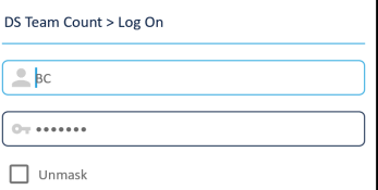

            #31442
            Asif Qureshi
              Hi ZAPTEST Team,
              After run the scripts field is not empty yet.
              See attached screen
              Regards,

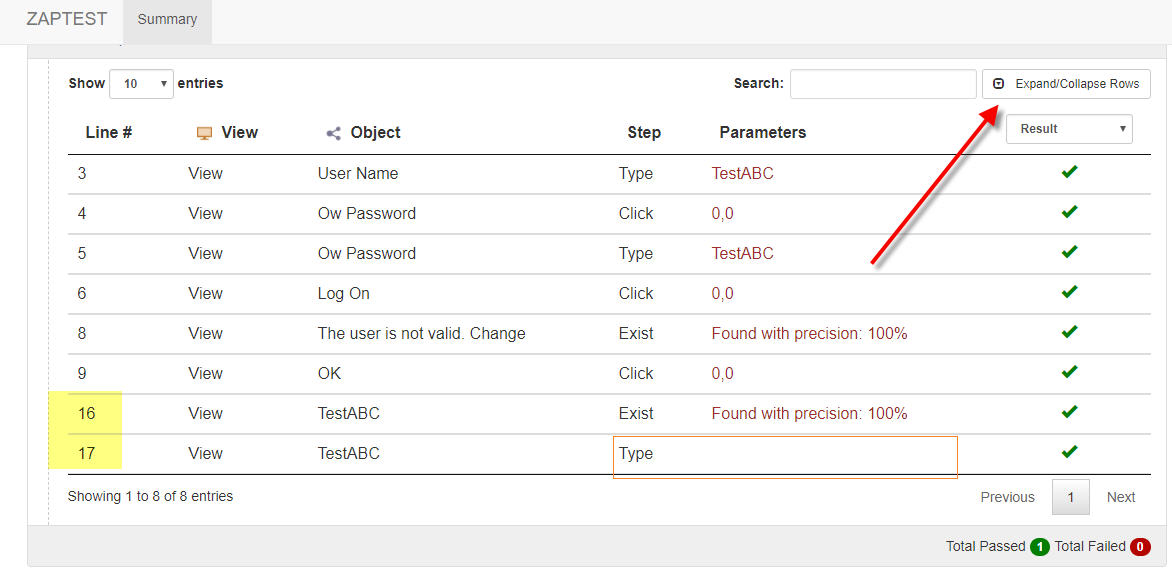

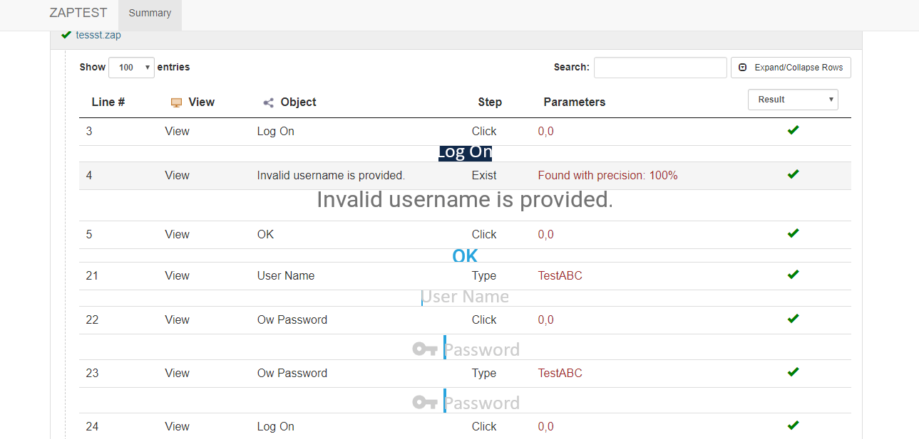

              #31443
                Hello aqu,
                In the final test’s results I cannot see if the expected object was found (Sometimes ZAPTEST may find similar object instead the required one):
                Please click the “ExtendCollapse Rows” button so we can see if rows’ #16 and #17 show the object.
                #31444
                Asif Qureshi
                  Hi ZAPTEST Team,
                  Now you can see the value. 🙂
                  Please see attachment.
                  Regards,
                  AUQ

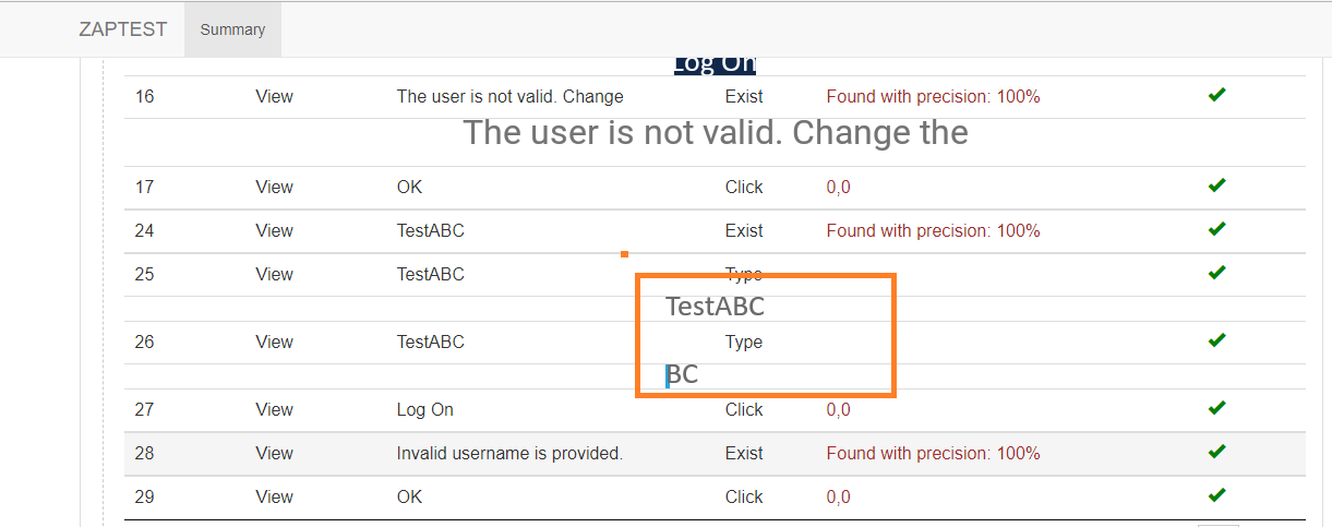

                  #31445
                    Hello aqu,
                    I need to see if the Exist method finds the object, if you expended all rows then as I understood now the Exist method’s execution is in line #24, correct?
                    If yes then it appears the Exist method found some other object and not the “TestABC” object (If this is true then this is the reason why the Type “” method’s execution did not work as expected).

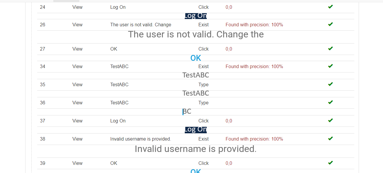

                    #31446
                    Asif Qureshi
                      Hi ZAPTEST Team,
                      See Detailed report.
                      Regards,
                      AUQ
                      #31447
                        Thanks aqu.
                        Change the Exist method with the DblClick method, and leave the Type “” method.
                        Please let me know if it worked.

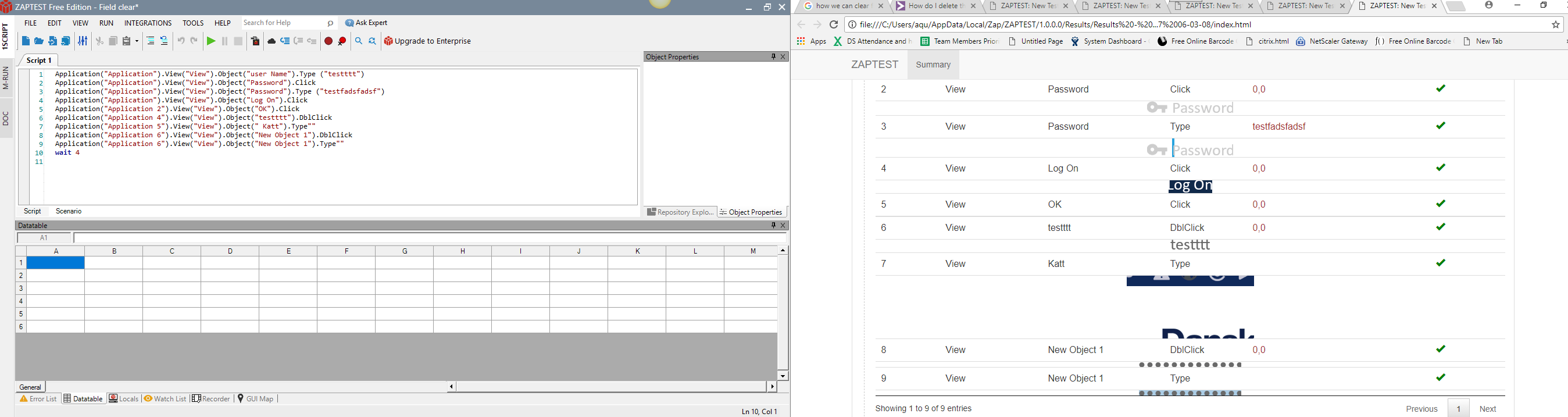

                        #31448
                        Asif Qureshi
                          Hi ZAPTEST Team,
                          After DblClick method, there are two issues are come.
                          Issue-1:
                          It take around 15 second to clear the field.
                          Issue2:
                          I used same method in password screen. it did not clear the complete field why?
                          See attached file
                          Regards,
                          AUQ
                          #31449
                            Hello aqu,
                            The 2 issues you’ve mentioned may be because the objects are not being recognized properly during Runtime.
                            Please try to use the following code (Change the “object” object to the one you wish to execute the code upon):
                            ‘Click on the object
                            Application(“Application”).View(“View”).Object(“object”).Click
                            ‘Click key Home keyboard key
                            Application(“Application”).KeyPress 36
                            ‘Press Shift keyboard key
                            Application(“Application”).KeyDown 16
                            ‘Click the End keyboard key
                            Application(“Application”).KeyPress 35
                            ‘Release Shift keyboard key
                            Application(“Application”).KeyUp 16
                            ‘Click key Backspace keyboard key
                            Application(“Application”).KeyPress 8
                            Please note if the above code will not work there is a possibility that you’ll have to redefine the objects in ZAPTEST Object Repository.
                            Please let me know if the above helped.
