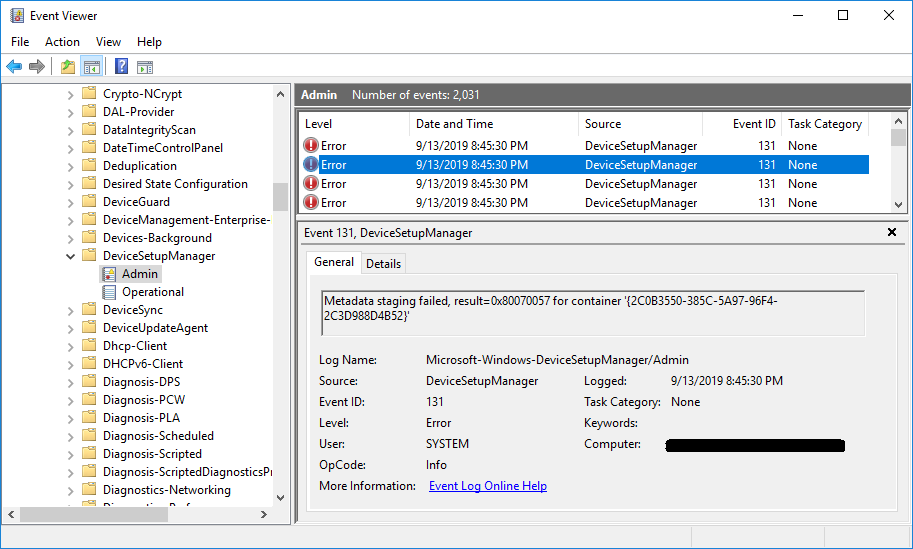

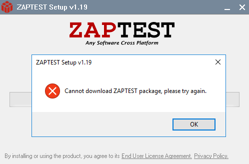

Unfortunately, I’ve got a new problem. When running the setup, I get an error saying that ‘Cannot download ZAPTEST package, please try again.’ (see attachment #1)
I have reviewed the user rights, firewall and the event viewer reported this Metadata staging failed (see attachment #1)I have reading the following articles and applying the ideas included, but there is no way to solve the problem…
https://social.technet.microsoft.com/Forums/en-US/4ffda40e-bc70-4a49-9423-cba3fdc7ec0d/devicemetadataserviceurl-httpgomicrosoftcomfwlinklinkid252669ampclcid0x409?forum=win10itprosetup
https://www.stigviewer.com/stig/windows_server_2012_member_server/2014-01-07/finding/V-21964I would really appreciate hear any other idea

KeymasterHello!
It seems IE blocks file downloading process.
Please use Offline Installer: https://www.zaptest.com/software/download-zaptest?offline-installer
