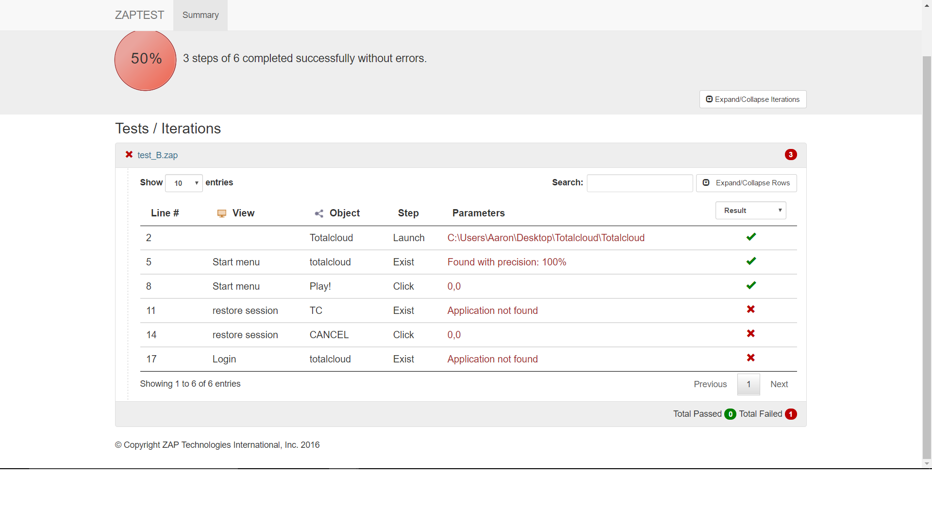

      I’m currently trying to test a login screen , I’m able to launch it but at the next login window(has a delay for it checks for updates) it says application not found. I tried increasing the timeout value also but I still got the same error.
      I could use some help with this issue , waiting for your immediate reply.

                Aaron, which one step you have problem with (line #)?
                I have installed this application and tried to run your initial script (except line 2 which refers to your local folder) and it works until line 14 where I can see this object doesn’t really presented (however I believe it is because I have no previous session to restore).

                  I’m having the problem from line #11 onward it says ‘ application not found ‘ . Till the Restore last session it works fine , once it reaches that screen it just stops every single time. I’ve attached the result
