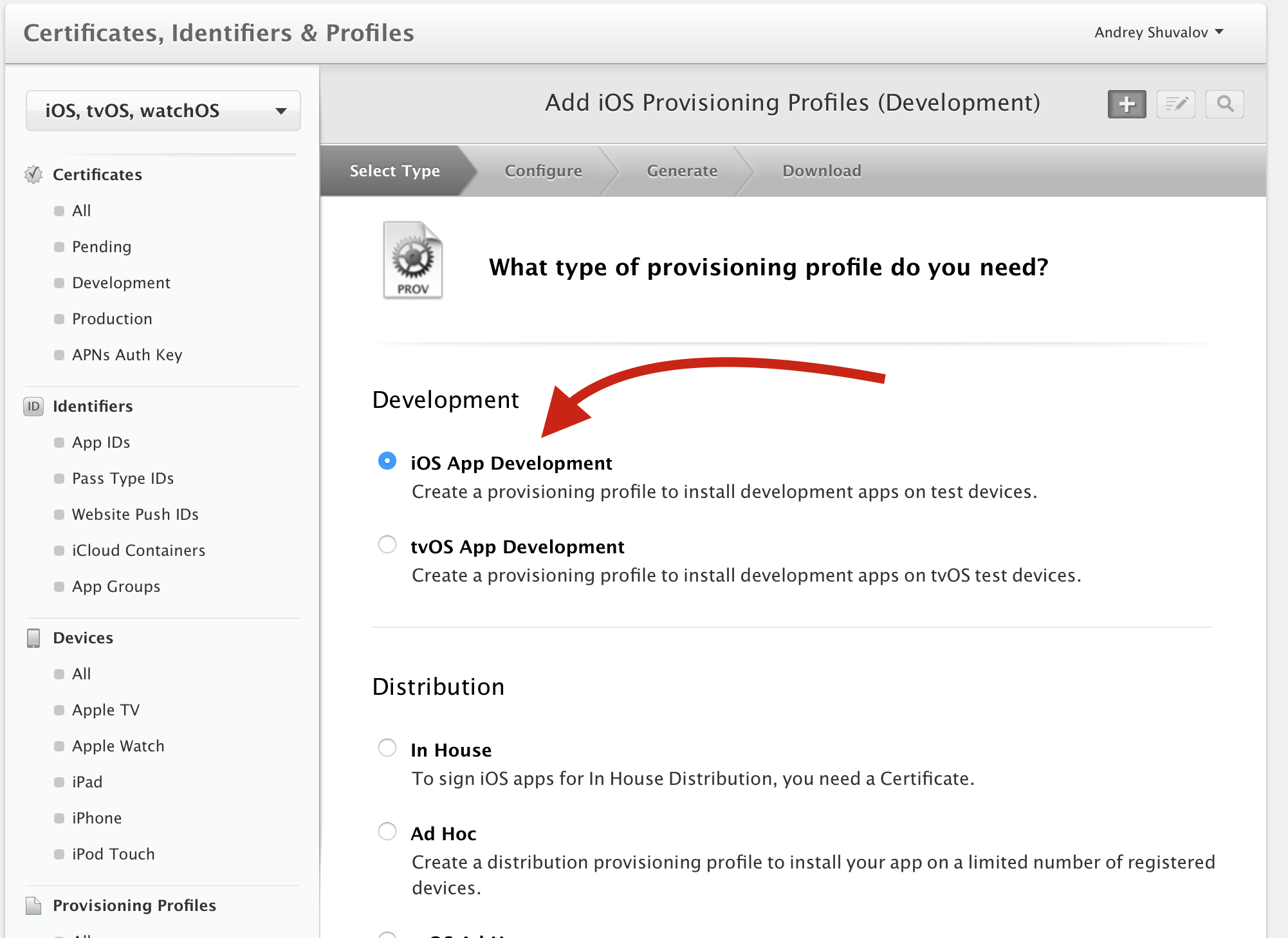

      How to generate provision:
      1. Open Apple Developer website and go to Certificates page
      2. If you don’t add your device, please do it on devices tab. You should provide device UDID for that
      3. Create new debug provision or edit exiting. Here you should include your device and certificates to provision file.
      4. Wizard will generate new provision file which you can use with your exported certificate.
      Hope that will help you. Common errors when the provision file is not corresponding with the certificate or the certificate is outdated. Please, let us know if you still have the problem with the certificate and provision files.

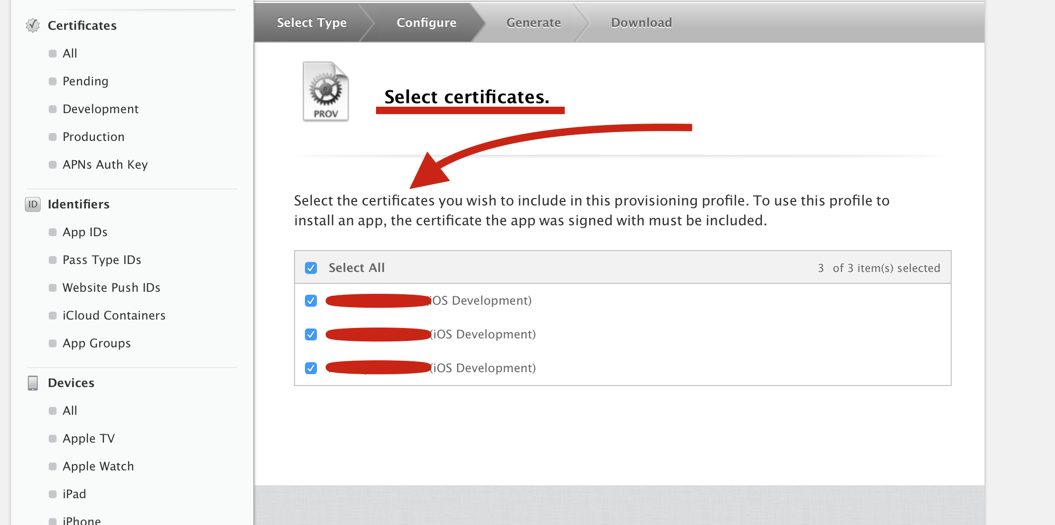

            for the provisioning profile – to create it: do I give it the .p12 file or the .cer file that was used to create the .p12?
            #31008

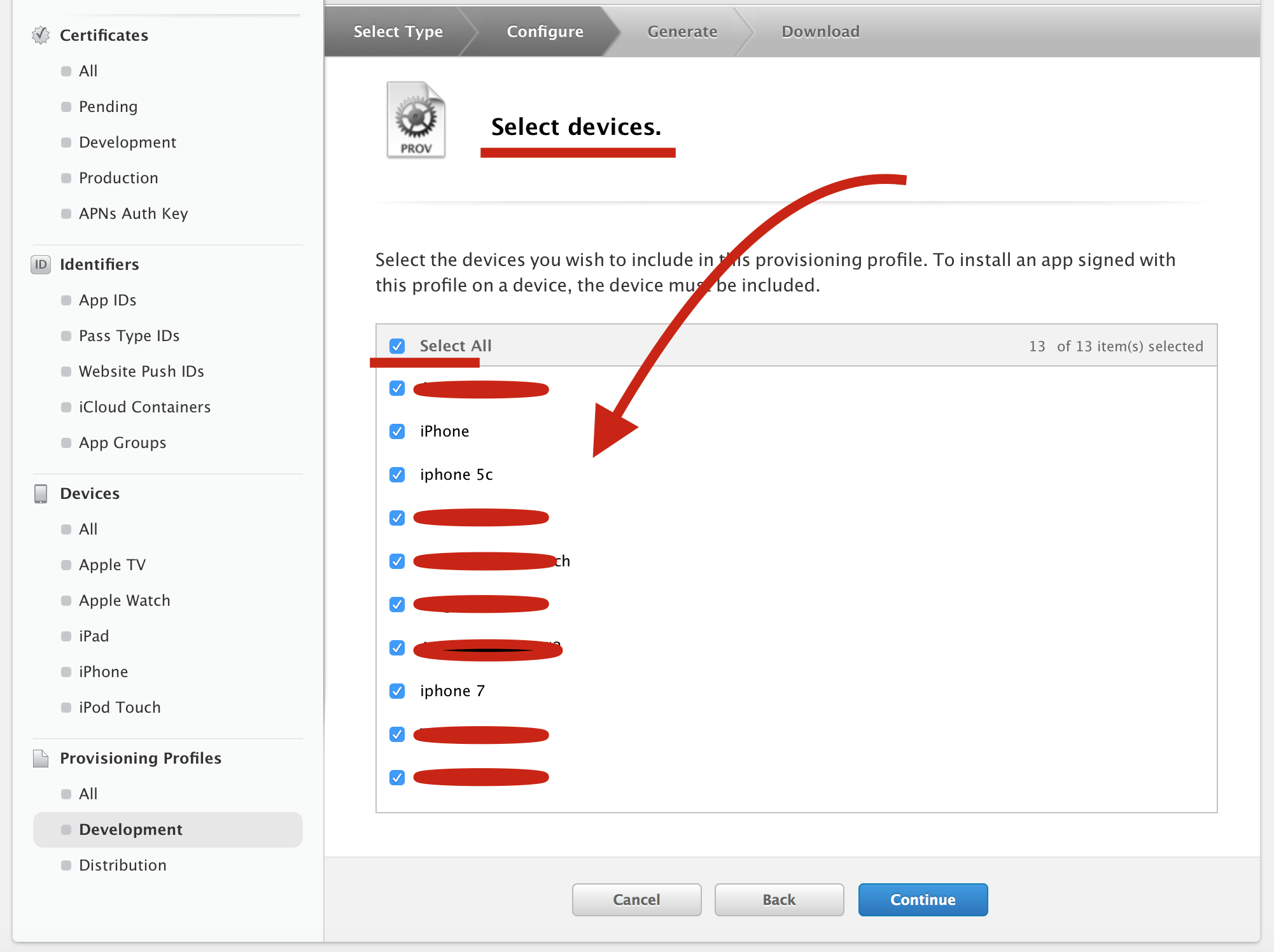

              Hello, Amahapatra!
              You should select the certs for your provision files when you create or update your provision (using Apple Developer WebSite): see the attached images.
              1. Select the Provision Type
              2. Select the assigned certificates (you should check your certificate, which you exported to “.p12” format
              3. Select the devices
